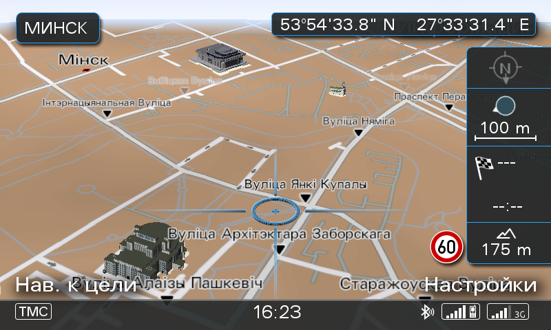

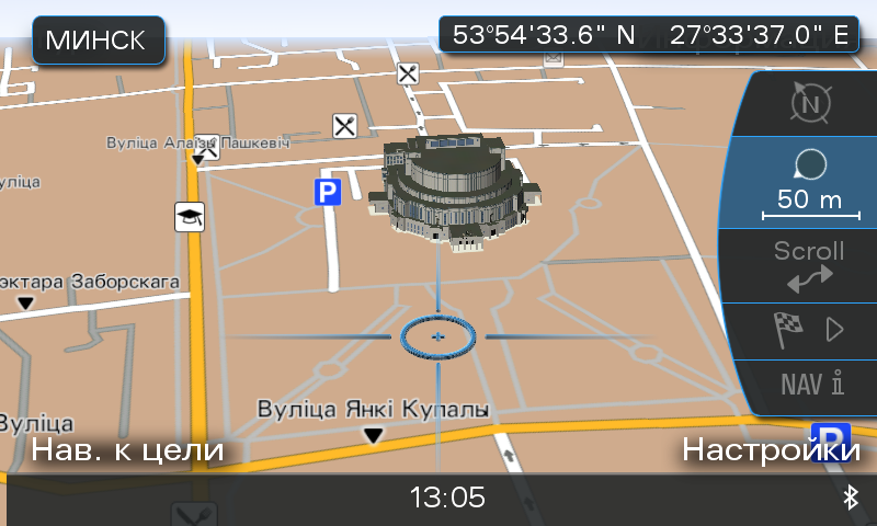

!!!!! В MMI Navigation/ MMI 3G basic-nav карты навигации отображаются в формате 2D (2-х мерном) в ММI 3G high/Plus карты навигации отображаются в формате 3D (3-х мерном).

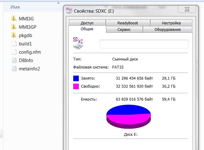

Общий объем карт 30,4 ГБ. Если столько не входит SD карту, удаляем "ненужные" папки.

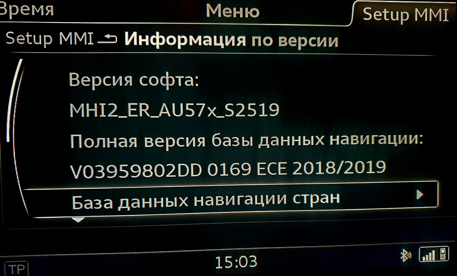

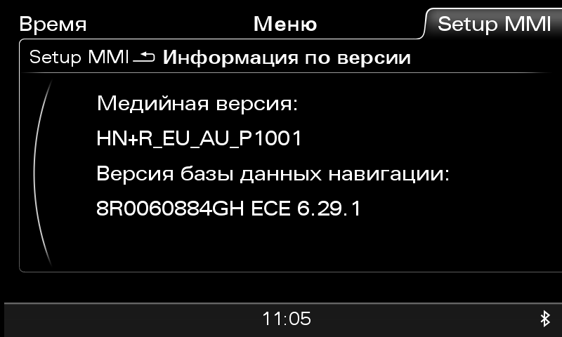

Как узнать какая навигация у меня установлена?
Проверьте информацию по версии Вашей системы и сверьтесь с информацией ниже:
MMI 2G: SW: XX-XX XX.X.X XXXX
MMI 3G Low/Basic: BNav_XX_XXXXX
MMI 3G High: HNav_XX_XXXXX
MMI 3G+: HN+_XX_XXXXX или HN+R_XX_XXXXX
MMI RMC: RMC_XX_XXXXX

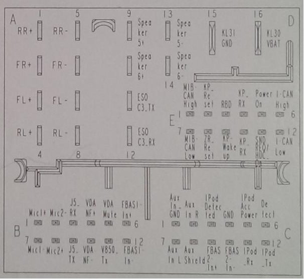

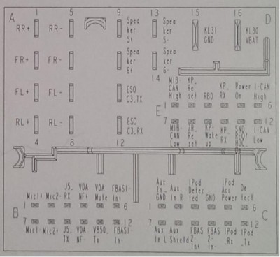

Step 2. Connect to PCM4 via UART
⁃ Connect GND to GND (PCM4 chassis works), RX on adapter to J5_TX on PCM4, TX to J5_RX on PCM4; pins B3 and B9.
⁃ To connect, you can remove the connector block from the quad-lock, then route your TX/RX/GND pigtails through the opening.
⁃ Open PuTTY, launch a serial connection to your COM port (see devmgmt.msc) - 115200, 8, N, 1
⁃ Login with root / oaIQOqkW

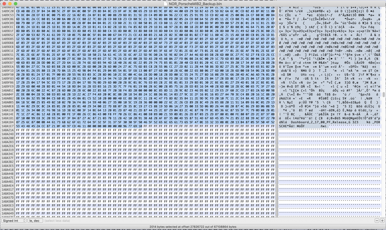

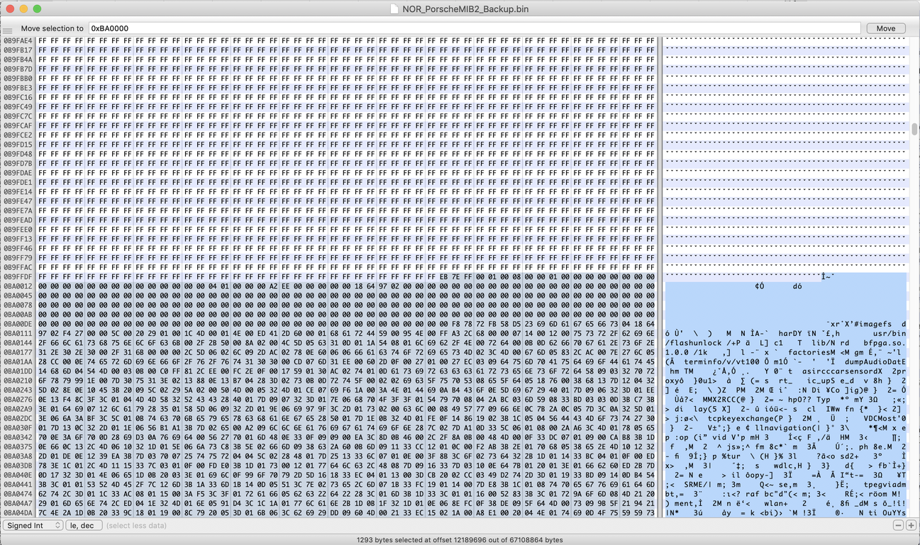

⁃ Open downloaded RCC NOR image (PCM4_NOR.bin) in your favorite hex editor
⁃ Jump to offset 0xBA0000, ensure IFS magic of "EB 7E FF" is present. If not, issue "flashlock" on PCM4 shell to obtain correct offset, target IFS is ~15.6mb. See screenshot:
⁃ Cut and paste this block of data into a new file, name it ifsroot_stage2_orig.ifs

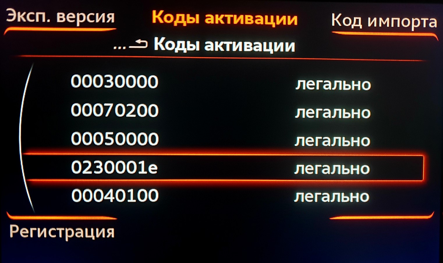

Step 7. Create your new FEC file

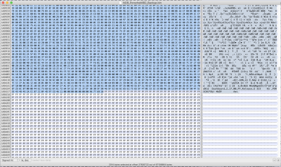

⁃ Open the FEC container (orig_FecContainer.fec) from earlier in your favorite hex editor
⁃ Copy VIN from file. This should match your car's VIN, unless component protection is enabled, then it would be the VIN from the donor car
⁃ Copy down VCRN (hex values of bytes 16-20 in file). Write it down as shown in the blue highlighted text in the screenshot. The VCRN may be obtained through measurement channels on PIWIS if you only have a 4 byte empty FEC file.
⁃ Make a comma separated list of your existing FECs, from offset 0x43 until the checksum begins. Use hex values, add commas at every 4 bytes (8 digits), for example, from screenshot it would be 00030000,00030001,(...),06310099
⁃ Add one last FEC to the end of that list, which will enable Android Auto: 00060900
⁃ You can also add other FECs to your PCM4 at this time, see below. Additional coding / adaptations may be required.
⁃ Download MIB2_FEC_Generator.sh from Github, chmod it to 755
⁃ Issue command to generate FEC Container "MIB2_FEC_Generator.sh -f {YOUR_FEC_LIST_CSV} -n {YOUR_VCRN} -v {YOUR_VIN} -d {Output_Directory}"
⁃ Output file is FecContainer.fec, copy this new file to your SD card

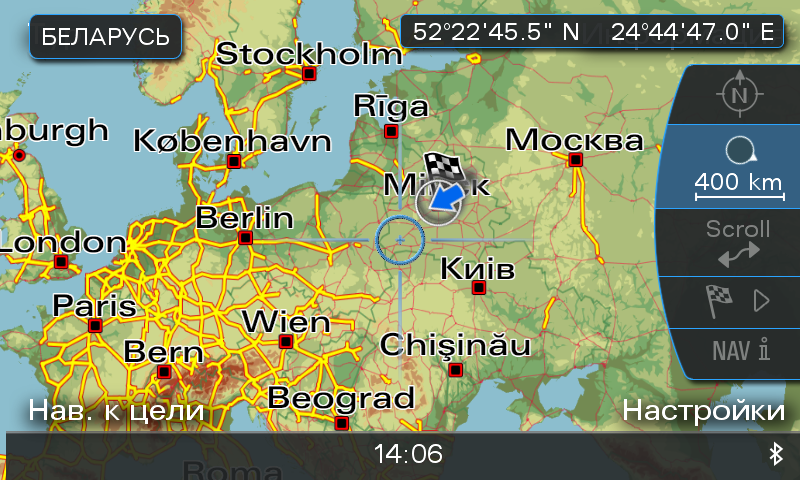

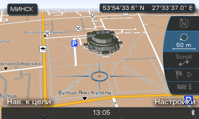

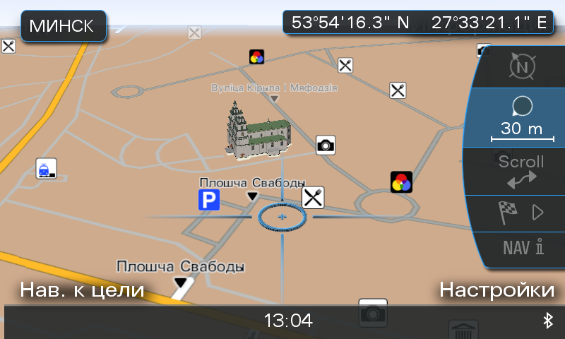

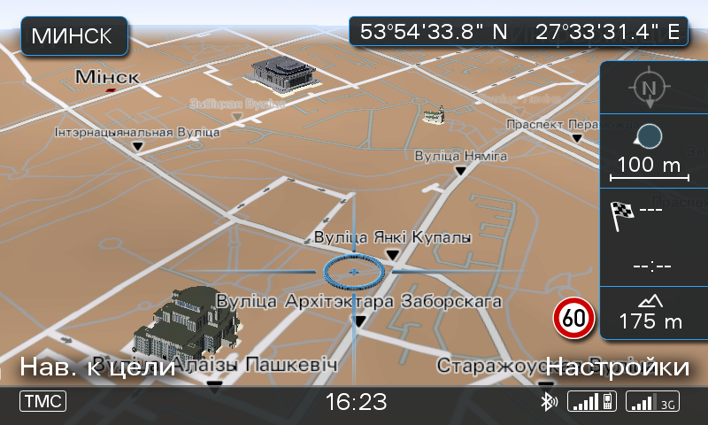

В Минске добавили новые 3D объекты:
Штатная навигация Audi MMI 3G

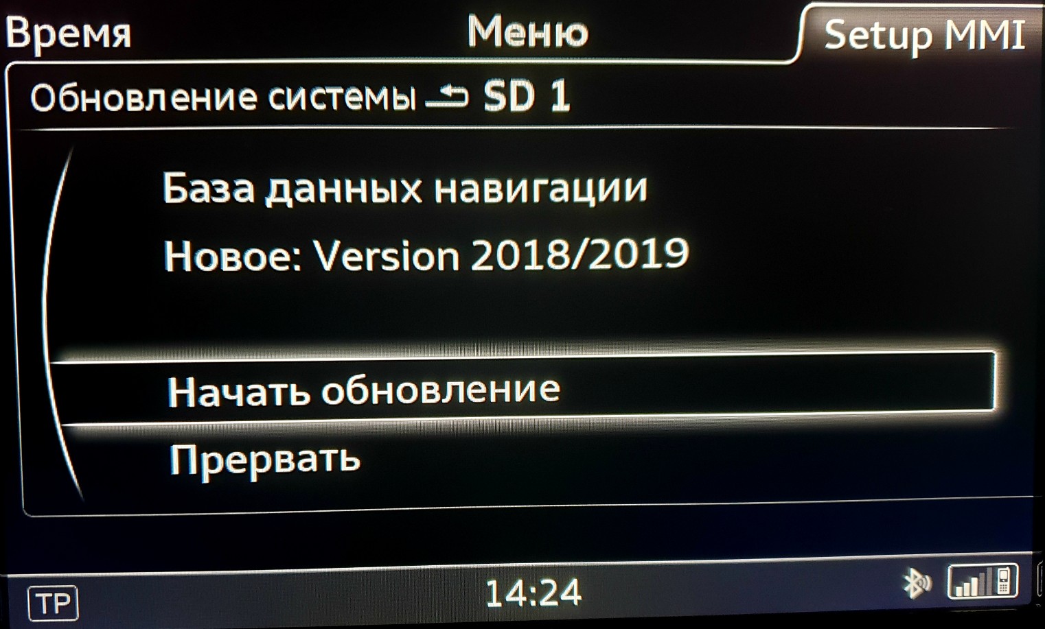

Сообщение Паша » 28 янв 2020, 13:21

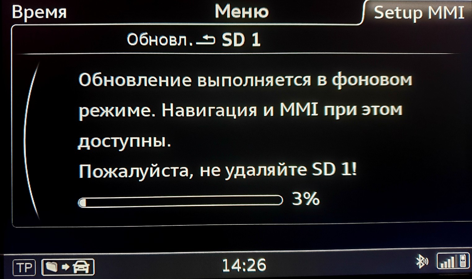

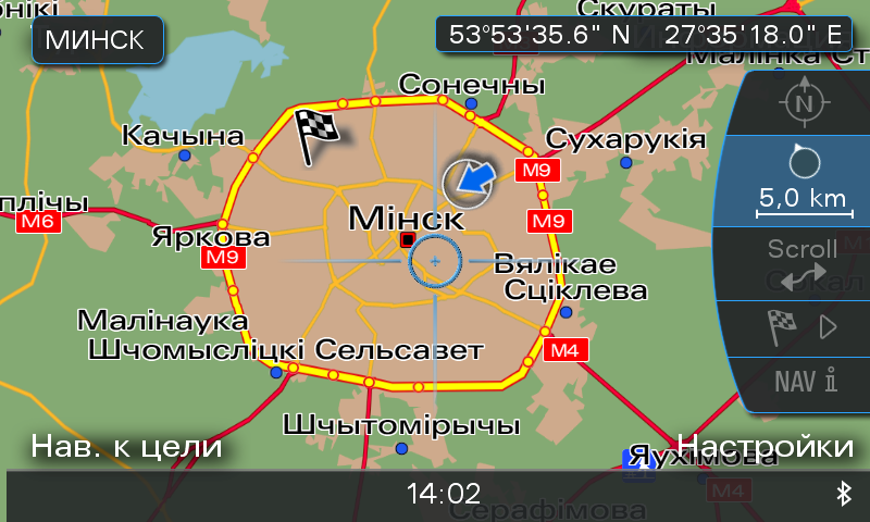

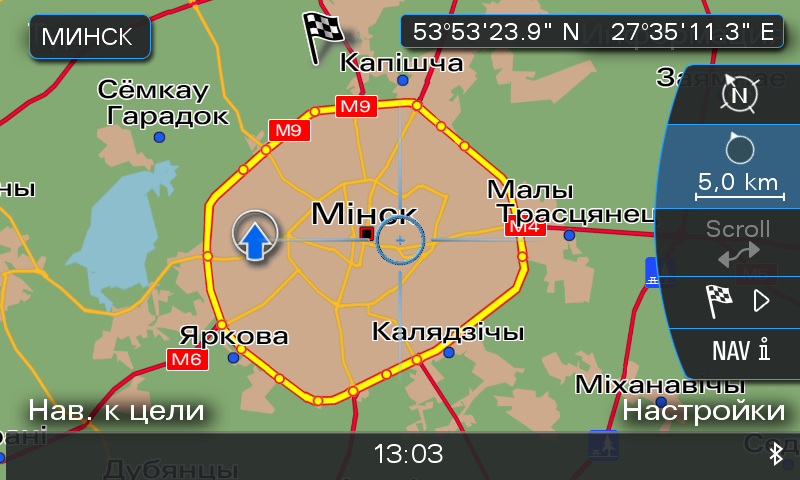

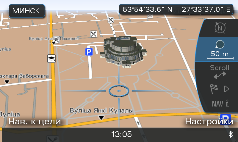

Обновил карты в своей Audi A6 C7 2014 на 8R0060884GS ECE 6.30.1 2020 год. Процесс обновления точно такой же, как и в прошлые многочисленные разы (в этой теме есть мои отчёты и рекомендации).
Было:
Стало:
Как по мне всё это баловство, лучше лишних пару тысяч километров мотануть с картами 2018-2019 года, чем 100 км по городу с новыми, 2020 года :-D

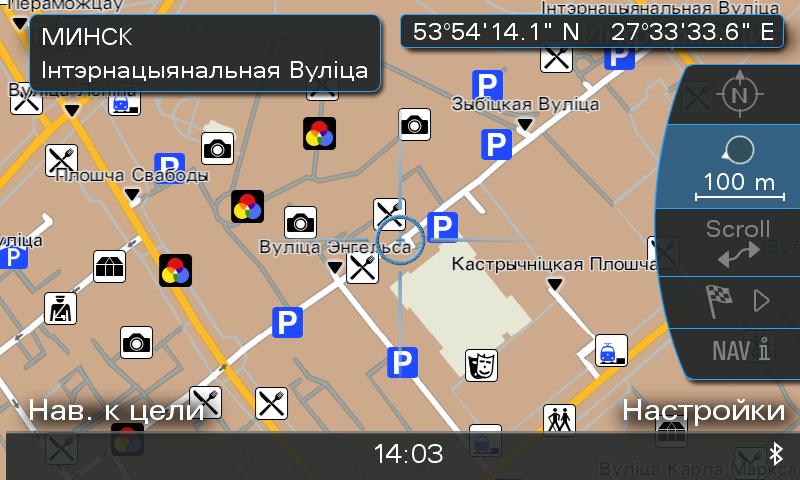

Про 3D объекты я выше писал:
 Скриншоты
Теперь что касается файлов для обновления карт. Занимают они на карте 30,2 Гб:
Предложу ко мне подскочить среди дня и я сразу запишу на Вашу флешку. Второй вариант куда-то выложить в сеть - тоже могу, предлагайте куда.

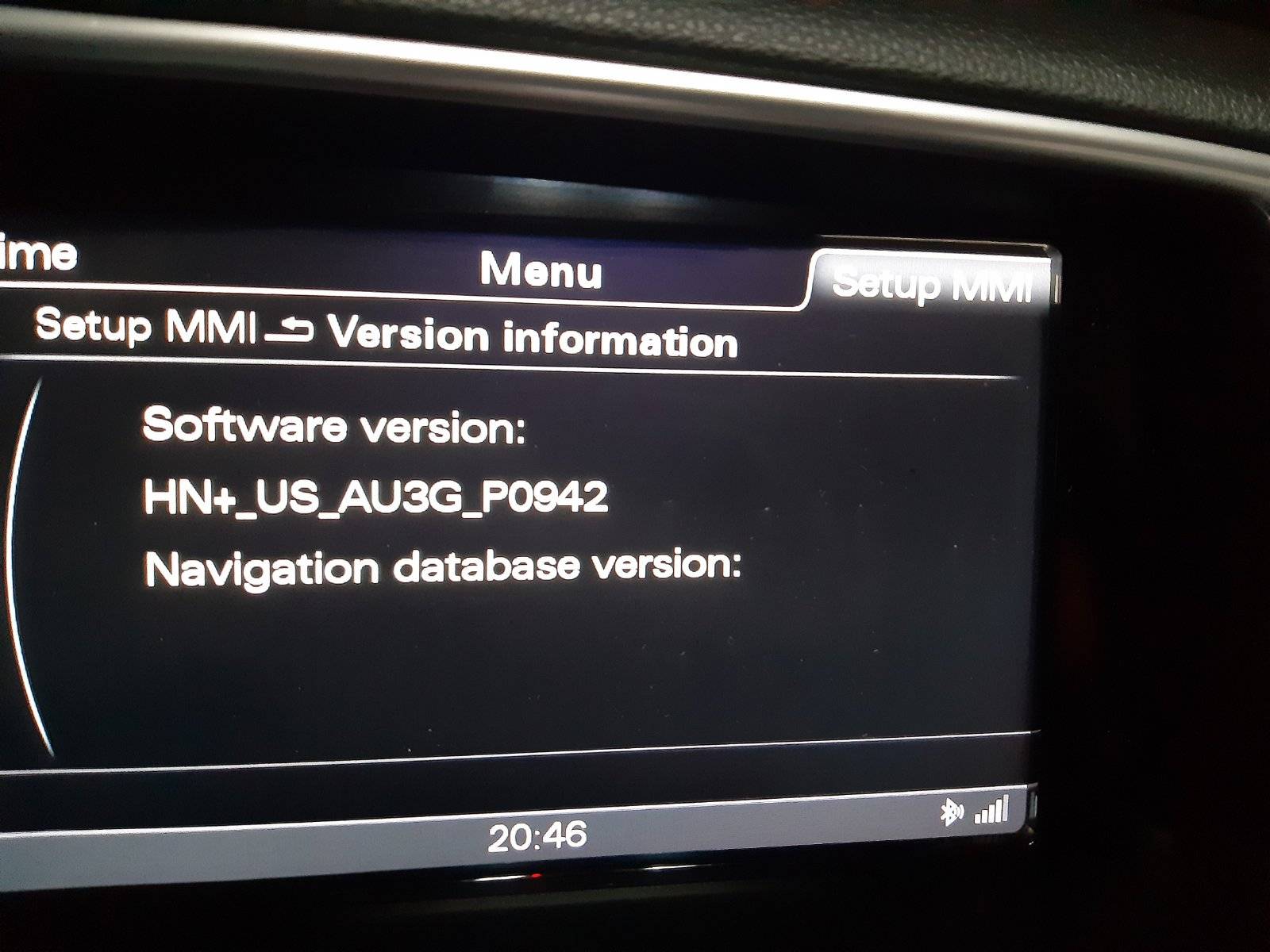

Товарищи добрый день! Подскажите советом на какую прошивку прошить мою Q5 2016г.в. америкос под европу, и навигацию тоже под европу какую версию лучше поставить?
Сообщение hp_unit » 30 янв 2020, 19:10
yuran, Без правки дампа еепром вы не зальете ничего туда. Ну или окирпичите голову.
