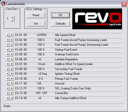

Изменить параметры впрыска можно при помощи программы Lemmiwinks.
Вот список каналов:
Ch01 : Idle Speed Offset
Adjust idle RPM level
- Higher number: increase idle rpm
- Lower number: decrease idle rpm
Ch02 : Fuel Tweak (Accel Pump); Increasing Loads
-This channel adjusts a fuel enrichment under load
-Modulates Throttle Response
Ch03 : Fuel Tweak (Accel Pump); Decreasing Loads
-This channel adjusts a fuel enrichment term coming off the gas or decelerating.
Ch04 : Start Up Fuel Enrich
Amount of fuel on any start ups?
- Higher number: enrich the mix
- Lower number: lean out the mix
Ch05 : Warm Up fuel Enrich
Amount of fuel on start ups E.G. on the first start in the morning?
Ch06 : Lambda Regulation
Controls how fast ECU adapts:
- Higher number: faster adaptation
- Lower number: slower adaptation
Ch07 : Additive Offset To Speed Limiter
Controls speed limiter in increments ok 1km/hr
Ch08 : Secondary Fuel Tweak
It adjust gain on the injectors responce
- Higher number will increase the injector responce (smooths the ride)
- Lower number will decrease injector responce (decrease backfires)
Ch09 : Ignition Timing Offset
Controls timing in steps of 0.75 degrees, all RPM range is altered
- Higher number advances timing
- Lower number retards timing
Ch10 : Primary Fuel Tweak
Controls fueling on run, ussually change multiplicative fuel trims
- Higher number enrich the mix
- Lower number lean out the mix
Ch11 : Unused
Unused
Ch12 : SEL Scaling (Turbo Cars Only)
Adjust fueling maps according to boost settings
- Higher number increase injection period for higher boost
- Lower number decrease injection period for lower boost
Ch13 : OFF OFF
Unused
Ch14 : Idle Torque Additive Offset
Controls engine load at idle
- Higher numbers: spec load at idle is increased
- Lower numbers: spec load at idle is decreased

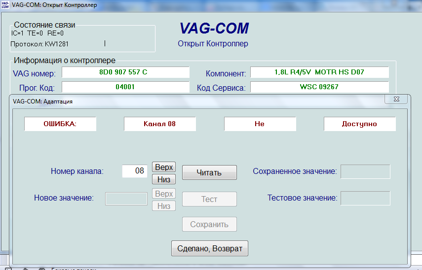

VIN: WAUZZZ8DZTA202742
Сообщение VoR » 18 апр 2012, 22:26
Сегодня взял кабель и пошёл побеждать сею проблему.Но НИ ОДИН из логинов не подошёл:(
пробовал эти
ADR (до 97 года вып.) = 06589
AHL/ADP/ARM/ANA/ADR/ARG/APT (МКПП) = 09675
потом даже эти
ADR (vin ЭБУ: 8D0 907 558) = 03256
ADR (примерно после 98 г.вып.) = 02145
После каждой проверки ждал 7-10 мин с выкл зажиганием,всё глухо.Подскажите,может ещё есть какие?Заранее спасибо :unknown:

Авто: A4 B5 1.8 1996г.в. ADR
Сообщение VoR » 28 авг 2012, 23:21
Andrik, какой Вам код подошёл? логин в смысле. я свой так и не подобрал!!! :twisted: скоро холода, начнёт чихать на холодную
Andrik
Сообщений: 496
Авто: а4 в8 1,8 TFSI
VIN: wauzzz8k18a029999
Сообщение Andrik » 29 авг 2012, 09:40
03256-с первого раза. Теперь вообще никаких проблем с заводкой!
VoR
Сообщений: 131
Зарегистрирован: 01 дек 2011, 23:25
Сообщение VoR » 29 авг 2012, 11:10
а блок электронного управления у Вас под таким номером идёт?
Andrik
Сообщений: 496
Сообщение Andrik » 29 авг 2012, 12:24
Даже не знаю, не смотрел.

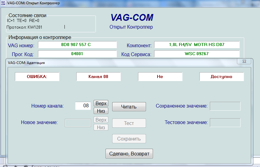

Сообщение andrei a4 » 30 авг 2012, 16:35
Всем добрый день.
хотел себе поменять обогащение смеси в фазе Старт и наткнулся на такую проблемку:
ошибка: канал 08 недоступно
A4(B7)\2007\1.9(BRB)
Извиняюсь, что не по теме вопроса. Добрый вечер!
А Вы с помощью какого логина вошли?
